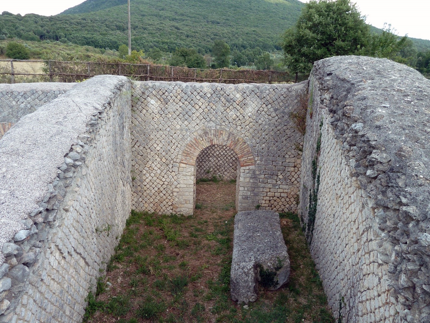

Mass Roman wall 300 BCE in Carsulae, Italy; Image: Brad Gellert

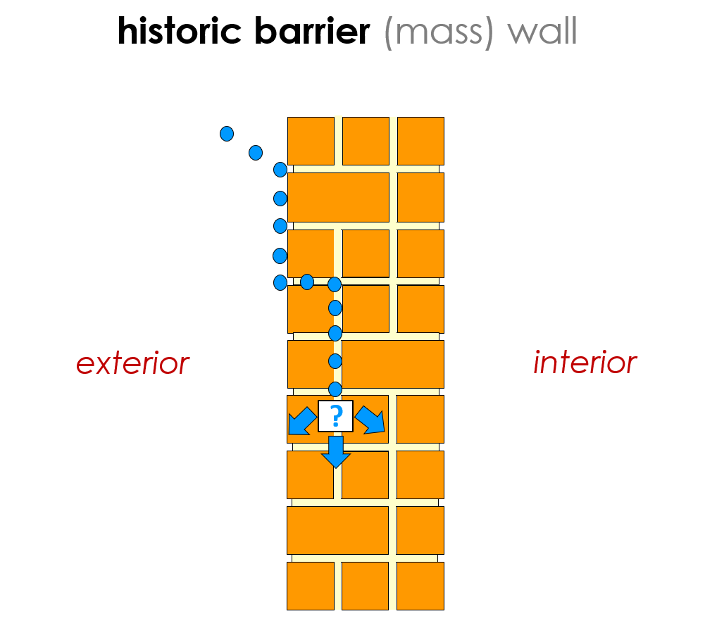

These mass masonry walls were constructed by skilled masonry crews and the mortars they used contained a high percentage of lime and very little cement which is a contrast to today’s building practices. This lime based mortar had the ability to allow a small amount of moisture to leave the wall system, however some of the moisture was absorbed by the brick that comprised these multi-wythe walls and dissipated within the structure, as in Fig. 1.
Fig. 1 historic barrier (mass) wall; Image: International Masonry Institute

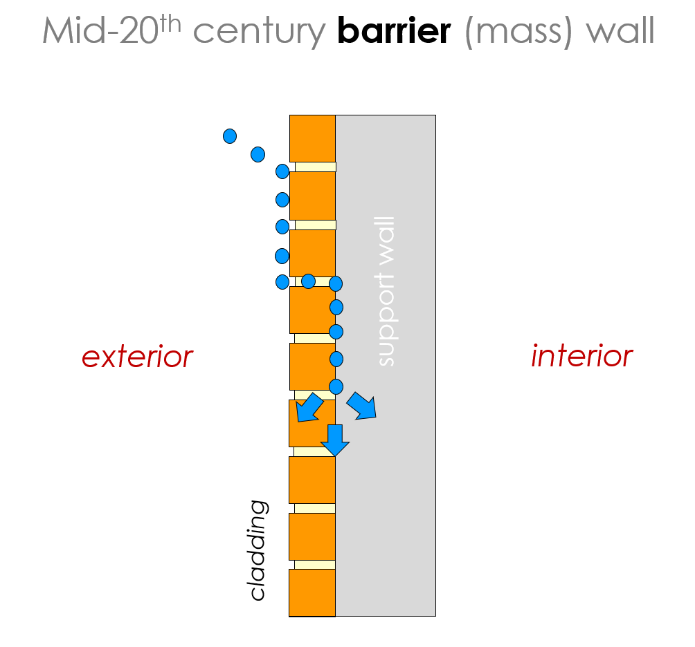

Mid-20th-century barrier (mass walls) were constructed with a masonry veneer with a support wall built parallel to the veneer with no cavity between the two materials. CMU was a common support wall material. Clay ‘Speed’ tile was also used earlier in the 20th century. These walls, as traditional barrier walls, used the mass of the wall to stop wall water from penetrating the interior.

Fig. 2 Mid-20th century barrier (mass) wall; Image: International Masonry Institute

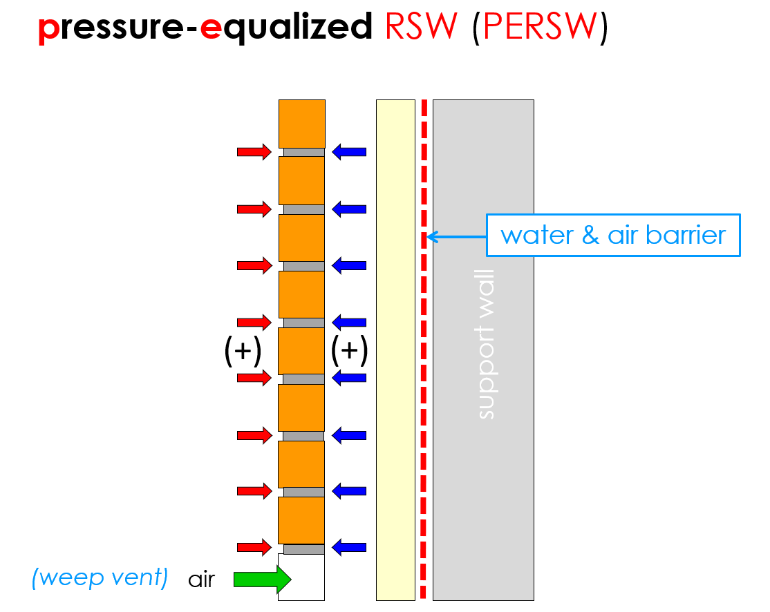

Masonry rain screen walls which resist the five main forces of water penetration: gravity, kinetic movement, surface tension, capillary action, and pressure difference through compartmentalization are the next design iteration in masonry veneer construction. Vertical cavity baffles, which break the cavity into compartments, limit moisture laden air from traveling horizontally; the compartments reduce pressure differentials in the cavities. BIA Tech Note 27 recommends that these compartments have closures no more than 4 feet. (1.2 m) apart at the sides and top of the building in a 20 foot (6 m) wide perimeter zone3. Without compartmentalization, pressure differentials can develop at building corners due to their different exposures that can cause suction to develop on one face drawing moisture into the cavity. Air pressure generated by winds, enter the cavity through the vents and equalizes the pressure in the cavity to the pressure outside of the cavity thus preventing wind driven rain from penetrating. BIA Tech Note 27 also provides guidance for spacing of these vents. For the pressure equalized rain screen wall (PERSW) to work, the air barrier portion of the assembly is critical; it must act as an air barrier to prevent pressure from leaking into the interior of the building.
The PERSW, with all the components it requires, not only is the most expensive of the rain screen wall systems but often is the most difficult to create. Just as the “mass” masonry walls of the past were constructed by skilled masonry crews, today’s journeyman modern masons have the training and skill required to not only assemble the exterior facade of these pressure equalized rain screen walls, but all the components to make the system air tight. Today’s masonry contractors can be a single source for the CMU back up walls, installing the air/vapor barrier, rigid insulation and exterior cladding.

The pressure-equalized rain screen masonry wall, meeting the AIA Definitions Project term, is designed to keep water out of the cavity thus minimizing damage to ties, insulation and the building interior.
