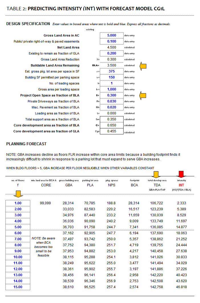

I have focused on the prediction of shelter intensity options with templates related to generic building design categories to quantify the evaluation of options within sustainable geographic limits. These building categories are part of a classification system for the Shelter Division of the Built Domain. Choices within the classification system lead to a specific forecast model. The values entered for each template topic in a forecast model are used by the model’s embedded equations to predict gross building area GBA options in its planning forecast panel. These GBA alternatives represent potential levels of intensity for a given buildable land area. Table 2 illustrates the specification template and forecast panel format of a typical model.

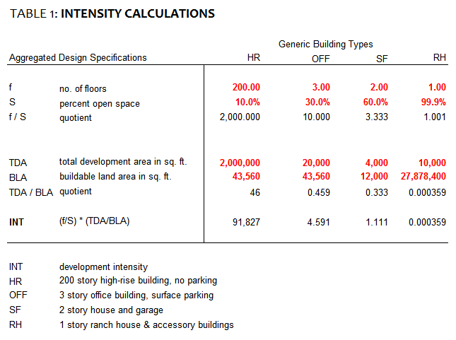

Multiplying (f/S) by (TDA/BLA) is a simple way of expressing these intensity INT relationships.
INT = (f/S) * (TDA/BLA)
The equation states that intensity INT increases with increasing f and TDA values. It declines with increasing S and BLA values. In other words, increasing building height (f) and/or total development area TDA increases the intensity INT on a given buildable land area BLA and project open space S provision.

Table 1 presents several intensity calculations to illustrate a generic range of intensity results. Table 2 illustrates how intensity is predicted in the forecast model CG1L when a full set of design specification values is entered.
